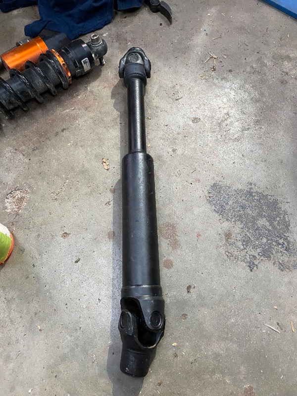

I had the rig booked in for inspection but hesitated and cancelled. I am not quite at the mileage for replacement.. Still I did my own inspection as I do all my own work. At first I thought something was wrong as being an Automotive guy the shaft is clearly not clocked correctly. But after several searches and conversations it appears as if they are all like this.
Can someone maybe explain WHY?? My whole life I have have been told it is very important to have it clocked correctly and experienced ones that are not.. BMW engineers know something different ???
The shaft from the 2018 R1200GSA 45000 Kilos
Anyways I reinstalled it and Like Ron I will order a new one as a spare and carry it with me.. It is pretty easy to change out on the side of the road if I need too. LOL
Edit. By the way my Rig has a slight driveline vibration on Accel.. Thinking this is why. ????
