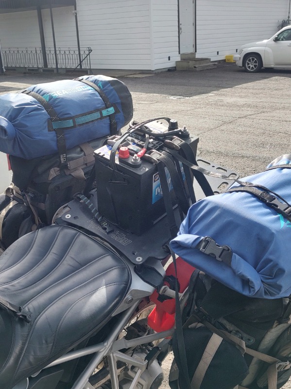

Fortunately for David there was a chap in Dease Lake who not only helped diagnose the problen as a dead stator (following directions from David's trusted mechanic back in the US) but who was also able to set him up with a used NAPA Marine starting battery and a set of heavy gauge cables with eyelets at each end such that he could connect the big battery in parallel with the bike's battery. The bike was content but of course the big battery has to be recharged periodically.
The battery on the back of the bike:
File Attachment:
File Name: 2547325604...8872.jpg
File Size:149.04 KB
On the first leg David managed to get over 300 miles on the initial charge! He had more good fortune along the way finding folks willing to give him some charging time from their vehicle. David stopped at Smithers to pick up a charger at Canadian tire and the service bay there was kind enough to put the battery on a big charger. The 3A charger he picked up at Canadian was more of a last resort since it takes quite a while to charge the big battery with it. Needless to say he was sufferinmg from "range anxiety" throughout.
As he made his way south David's impression was the the battery we discharging at a faster rate which is probably the case as starting batteries don't like to undergo deep discharge.
He made to Kelowna and our place where I confirmed the stator diagnosis (there was continuity to ground from the stator coils so the insulation had failed). David joined the gang for breakfast at Pur and Simple on Wednesday morning. Gary changed the rear tire and installed the new tire pressure sensor. We all agreed that it was probably prudent to get a deep cycle battery from Canadian Tire as it's better suited to deep discharge and being larger had twice the capacity so we made the switch in the Canadian Tire parking lot. We also swung by the dealership to pick up a new rear mudguard as the original one had been damaged during the trip north and we installed it at our place.

I am pleased to report that David made it to Eureka MT on his first day a distance of 431 miles! At that point the battery voltage had fallen to 11.4V.

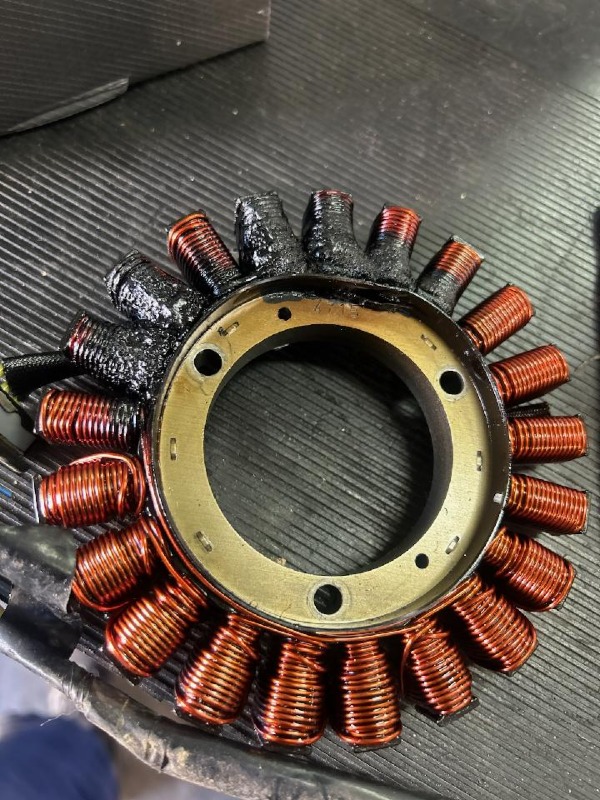

David made it home to Colorado and trailered the bike to Arizona where he has a mechanic that he trusts.
Here's a photo of the burned out stator.

Good on you for helping David out. Glad to hear he made it home safely. 431 miles is pretty impressive range on that deep cycle battery. Do you know if he reduced any lights for the trip?
2 years 1 month ago #1041 by RadioFlyer
He travelled with the stock lights on and the auxilliary lights off. He tried to avoid situations where the engine would get warm enough that the fan would come on. Coming down from Dease Lake it would have been nice to have the heated gear turned on but of course he couldn't do that.
