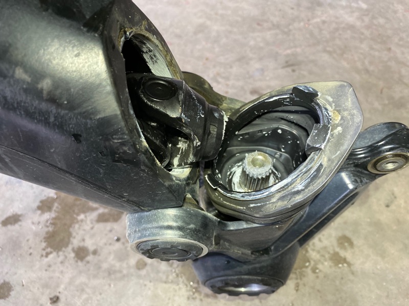

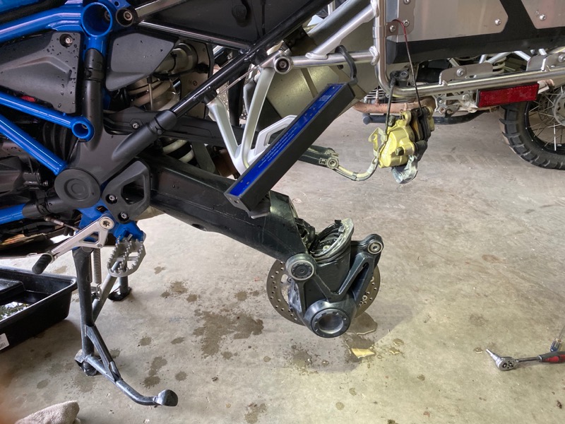

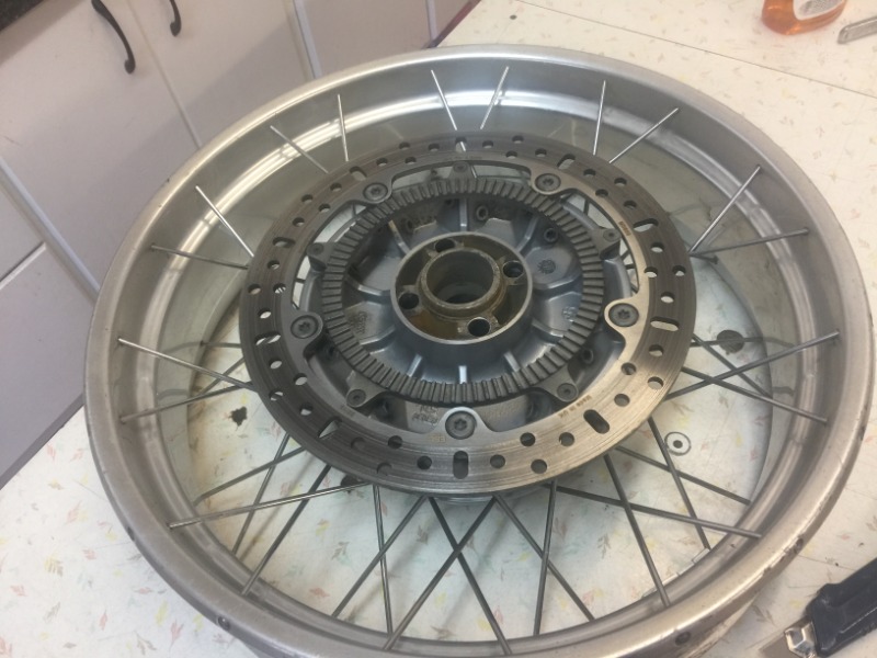

Finally got the GSA up to 10 k. Oil change, dropped the rear diff to check splines. new diff fluid. Checked the wheels as I have heard that the spokes can be an issue with the 2018s. DAMIT. just about every rear spoke is a dull thud. and most of the fronts with 3 on the front that rattle they are so loose. Might be that thumpity Thump I feel in the foot pegs. Now to see if I can get warranty. Hmmmm who do I phone???

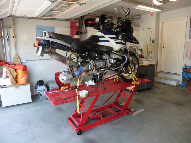

It's time for Gumby to get a new pair of shoes. I'm very pleased with the performance and wear of the Pirelli Scorpion Trail II's. My last set lasted over 16,000 km and I really liked the ride. For a 90/10 tire they worked pretty good on gravel roads as well so I ordered up a fresh set from FortNine back in February and it's time to change.

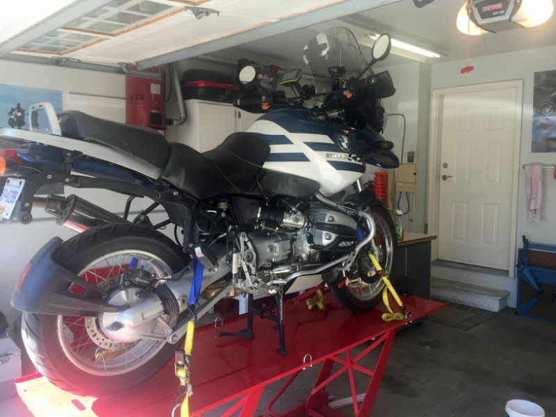

First off, let's get him up on the lift.
Started with the back tire. I like to get the harder job done first.
Here's where I ran into an issue. I'd ordered a set of angled valve stems from Fortnine. Nice looking set from BikeMaster. I got trapped by the web site. There are six different colors of valve stems on the same page. I thought they were all 11.3 mm stems. It turns out that chrome ones I ordered were the only ones that were 8.3 mm. Unfortunately I had already cut off the old valve stem (it was hard as a rock) so we're done for the day.
