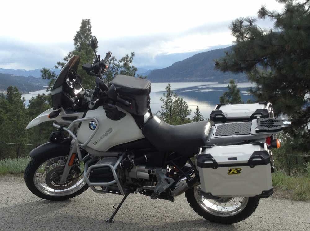

I'll post a picture of the bike, post-rebuild, along with a shot of the failed driveshaft u-joint that started the whole process, and a picture of what the bike looked like just a few short weeks ago!

Wow, you have been busy. I feel like a lazy sloth by comparison. The picture looks awesome and it should look even better on Sunday.

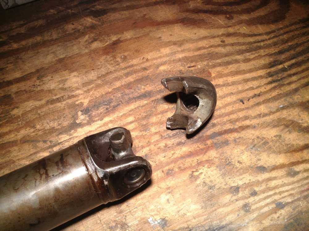

Failed driveshaft u-joint

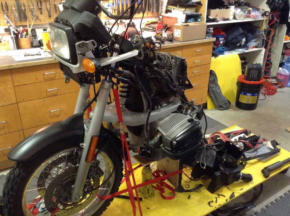

What the bike looked like just a few short weeks ago!

tskucher wrote: Failed driveshaft u-joint
I see what you mean by a "Catastrophic Failure". Did the shaft give you any advance warning? Such as vibration?
